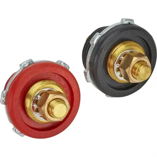

The second way you can do this is to purchase remote battery cable firewall bulkhead connectors, which you cut the cable and put wire ends on them, then bolt the ends onto the bulkhead connector posts, one inside and one outside of the cabin. This seals the cabin so you don't have moisture ingress. They look something like this:
