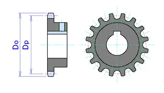

If you look at the image below (which is from your wikipedia page):
You can see where it has (on the left hand side) two dimensions given: Do & Dp. You can also see on the tooth (in blue, at the top of the gear, shown at the left) is angled at the top, tilting in on each side. This is what is meant by profiled. It isn't a straight cut gear, but has a profile. This allows so the gear itself does not interfere with the chain as it rides along the teeth. It helps to keep the chain from rubbing on the gear. If the profile was not there, the outer edge would continually grate on the chain until something wears out.
