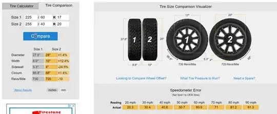

This is a useful resource when choosing tire sizes:
Tire Size Calculator
Comparing the two sizes you mentioned gives this:
Size Comparison
Note that the R20 tire, overall, is just a bit larger than the R17 tires. So clearance-wise it should not be a problem.
You do realize, however, that the number following the "R" is the rim or wheel diameter and you cannot put R20 tires on a 17" rim or R17 tires on a 20" rim. So to change sizes you will need to replace your rims/wheels.
