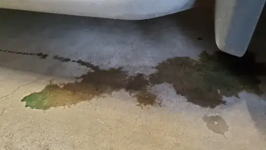

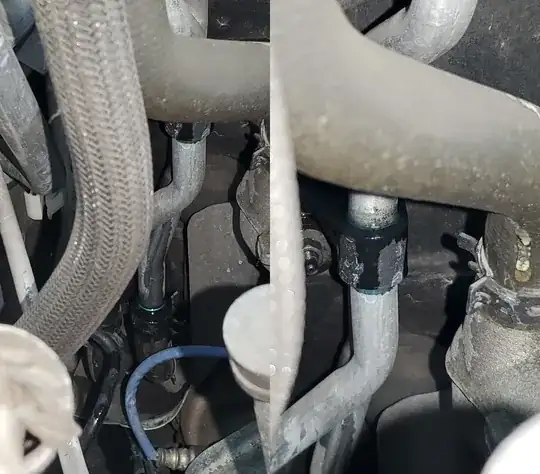

First, I don't know a whole lot about vehicle repair. I've only done some minor repairs on my truck like sensors and anti-freeze types of repairs. I noticed this puddle of green fluid on my garage floor today just as I returned home. Tracked to these pipes on the passenger side. Any idea what this fluid is and how soon should I take it to a mechanic or attempt to fix it myself?enter image description here

Regardless of the engine (v6 or v8), this is most definitely a coolant leak. Looks like you are losing enough coolant you should probably get that looked at as soon as possible. Is it an emergency? I can't quite tell. It's enough I'd be worried about it, especially if you do any stop/go type driving (city). Whatever you decide to do, ensure you are double checking the coolant level in your rig before you drive it to ensure you've got enough to not cause issues. This is most likely something which you could do, but you'd need to figure out exactly what is leaking and where it is leaking at. Then find the part to replace it, which may be a lot of fun. The dealership is most likely where you'd find a replacement part. If they don't have one, they can give you the exact part number so you can cross reference it to the aftermarket.

For your case, it looks like coolant is in the area of that black P clip holding the hose.
Start by picking a time when you can be without the car for a while. Don't tear your ride apart on Sunday night when you need to drive to work the next morning.
I'd open that P clip bolt, and see what you see inside. Use plenty of illumination and don't be afraid to poke and push and bent rubber pipes. If they're cracked, they already need replacing.
Avoid drinking coolant or getting any in your eyes, but its not as bad as other fluids in your car. If the engine is hot, the coolant could be 100 degrees C at room pressure, so let it cool a bit.
Most of the engine's coolant piping is around the front, between engine, water pump and radiator. The only hot water pipes that go toward the cabin are the ones for the heater matrix in your dashboard. But its all one pressure-domain so a leak anywhere will affect everything.
