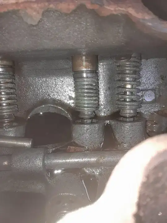

I've got 'em all freed up except #s 5, 6 and 7 exhaust. They're still stuck in the guides and the guides are sliding freely up and down in the block. The retainer clips slide right out.
And that's where I sit.
If they were on the intake side I could soak 'em in solvent and be done with it. But they're on the exhaust side, which means that anything I put in there drains right down through the block into the manifolds.
I'm headed back over there again Thursday, when I hope to borrow a friend's pickle bar and see if I can somehow pry 'em loose (first time through on a flathead, for me). The only thing I can think of is to hope the tangs on the bar are thin enough to fit into the clip slots, hold tight against the opposite side of the intake hole and rubber mallet 'em on the driver's side of the block. (Prolly will ruin the guide that way. Yuk.)
Here's what it looks like (this is mainly #6, with #7 slightly visible to the left):
Any ideas?

In a flathead, the only thing holding the Valve Assembly (in flathead-speak) steady in the block is the retainer clip (see the photo of #6 intake above, the one all the way to the right). The spring then pushes between the clip and the keepers and holds everything together. Without the clip, the whole thing slides easily in and out. By design.
My own gaffe came about because I didn't pull on the valves again after I removed the clips. Now that the assemblies slide right out, I'll just soak each one in a soup can of Marvel until they come loose on their own.
