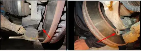

I found what was causing the noise. There is a small metal plate, roughly sized and shaped like a one of those little wooden ice cream spoons that come with a Dixie cup. It is positioned suspending from the bottom of the hub parallel to the back of the rotor. On both sides of the car it was touching the rotor causing the noise.
On the driver side the front portion was touching, and on the passenger the back, which I suppose explains why it seemed to come from one side when backing up and the other when driving forward.
I have bent this plate back a little and the noise is gone.
So the question is what is this little plate for, and why was it suddenly scraping on both sides?
A picture is attached.

It looks almost like a rotor shield that was partiality form off Late GM models were known to have them intact a customer of mine had a 2009 Pontiac that had the same thing. We bent it back with a hammer and screw driver. Never heard the noise again
