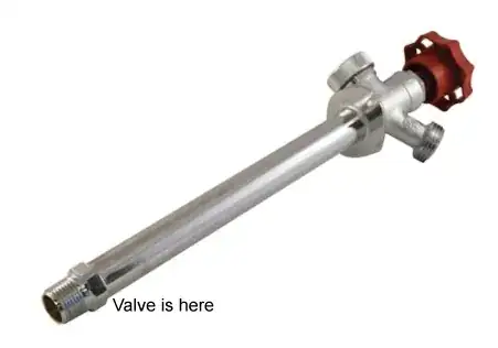

The way most people deal with the salt issue in winter is either (1) go to a car wash, (2) use a frost free sillcock and a garden hose, or (3) hope for the best and wait for the spring rains to wash off your car. I can almost guarantee that if you go the bucket and battery pump route, you'll be the only one in your neighborhood doing that.
With a frost free sillcock, there is no winterizing. As soon as you turn off the valve and disconnect the hose to bring it in the house where it won't freeze, the sillcock drains itself automatically and it is thereafter not subject to freezing. This is because the valve that cuts off the water is located deep within the house on the warm side of the insulation. The knob outside the house turns the valve via a long shaft.
e
This really is the best solution to your problem, since you can use unlimited water and you get full water mains pressure.
Don't forget to rinse the undercarriage, where the worst rust will take hold if salt is not washed off. There are undercarriage washing gizmos that can be slid under the vehicle on a long pole.
(Photo: homedepot.ca)
