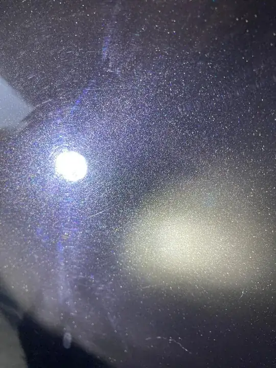

I have used black paint and 2K glossy clear coat to spray paint some parts of my car. I was wondering though, that my paint is not exactly the same as other parts of the car. It is "shiny", because of the glossy 2K clear coat. But it's missing something...
My paint looks like this:
my paint
Original paint:
original paint
What are those tiny little shiny things in the original paint?

The tiny shining things in the original paint are metal particles, which is why it is called metallic paint.
I guess you should have bought a duplicate of the original paint spec. Anyway, it's notoriously difficult to get an exact paint match, which is why even the experts want to repaint a whole panel.
But even then, in some lighting conditions you may be able tell the difference. I bought a car on a dry day that was parked in full sun. I eyed up the panels and the paintwork, but it was a full two weeks after buying, at twilight, that I noticed a colour mismatch on a resprayed door.
Weather Vane
  • 2,472
14
While the first answer is good, it is somewhat wrong. If the area repaired is small enough, we will opt to blend the color into the rest of the panel and then clear coat the entire panel. However if the repair is to large (repair consumes most of the panel) then doing as mentioned above will only result in a "butt match" mismatch-very noticeable. The correct solution is to paint the entire panel and blend into the adjacent panel and fade into the original color and clear coat both entire panels. This lets the mismatch color slowly fade away making it much less noticeable.
