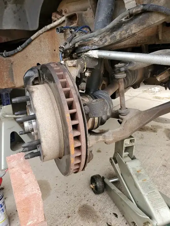

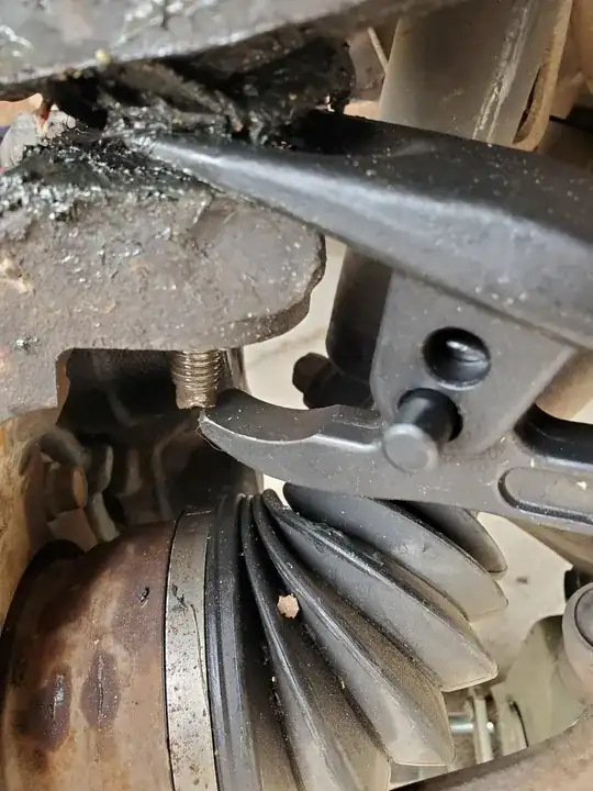

I am trying to separate the upper ball joints from the steering knuckle on a 2003 Hummer H2. I have tried using a pickle fork to separate them but it will not budge by any means. I tried using a ball joint separator from Harbor Freight but the throat opening is not wide enough to fit the ball joint stud and the steering knuckle nor is the split/fork end opening wide enough to fit around the ball joint. I also tried a ball joint separator from Advance Auto and Auto Zone and the opening was just too short. See picture of Harbor Freight tool below: enter image description here
And here is the Auto Zone tool: enter image description here
The throat opening on the ball joint separator is 2-1/2 inches wide and the fork opening is 3/4 inch. I can find a tool with a wide enough fork opening but not one with a wider throat opening. I looked online for a ball joint separator that opens more than 2-1/2 inches but the ones that have the largest openings are just only at 2-1/2 inches, most of the tools are just 2-1/8. CV axle is in the way so I can't use a C clamp. Is there any tool out there to get this separated other than a pickle fork? I even tried standing on the pickle fork when I wedge it in and no avail. I'm not sure how I'm even going to get started on the lower ball joints. Below is what I'm working with here: enter image description here The boots on the upper ball joint was already torn before I began working on it. Don't mine the vegetation, that got onto the pickle fork first, not in the ball joint boots.

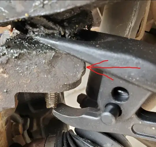

There is a much, much easier way to get the ball joint separated than with the tool you're trying to use. It's called a hammer, BFH, whatever. The trick is in how you hit it to get it separated.
Thread the nut back onto the ball joint, but leave space between the nut and the knuckle. Then turn the steering so the tire (if it were there) would be pointing outwards. This will give you access to the knuckle. Then, with a BFH, strike the knuckle dead on where the red arrow is pointing. Of course you'd want the ball joint separator out of the way. You may need to put the pry bar in between the A-arm and the knuckle, but considering there's already downward force being applied to the knuckle from the torsion rod, it shouldn't be an issue. One (or maybe a couple) of good whacks and it will separate with zero damage to anything. Just make sure you're ONLY hitting the knuckle. My boss at a wrecking yard I worked at many moons ago showed me this trick and it has never failed me yet.

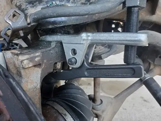

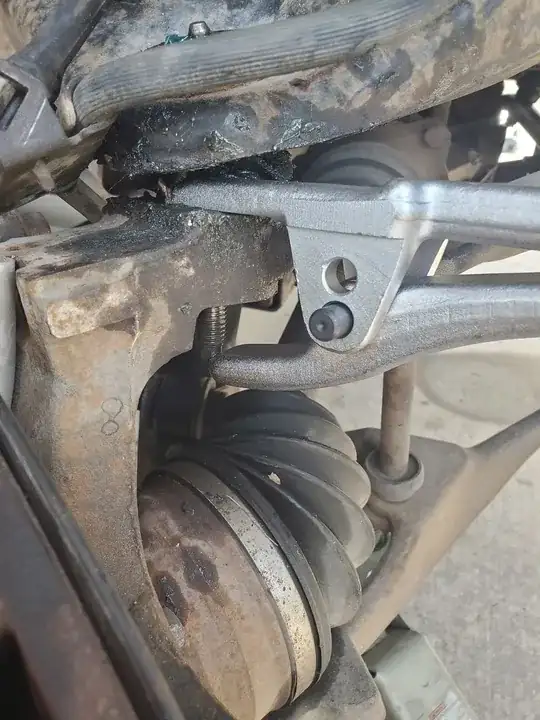

Turns out the jaw opening of the Harbor Freight ball joint separator was large enough to fit, just the fork splitting was not wide enough. The fork splitting on the AutoZone ball joint separator was wide enough however, so I combined the two and had something like this and was able to separate the upper ball joints from the steering knuckles.
