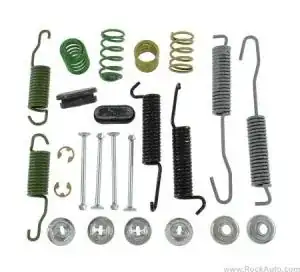

What you are looking for is an "all-in-one" or "combo" brake drum hardware kit. You can pick these up from most of the major parts stores. Here is an example from RockAuto.com with it's corresponding picture:
Brake Hardware from RockAuto
This should be enough for one axle. I'm not sure if front/back are the same, but I believe so. You can get the other bits and pieces (ie: self adjuster) from RockAuto.com as well, but would imagine you can pick them up from your major parts stores.
The Impala was built on the GM "B" platform, which is a full-sized, rear wheel drive auto. Cars such as the Buick Wildcat, Oldsmobile Dynamic 88, and Pontiac Bonneville & Catalina models were based off the same platform. GM is renowned for cross breeding its fleet. I don't know exactly what years it spans, but would bet you will find the same exact brake drum kit covering several years. I will tell you it looks very familiar to me, as common to GM vehicles which I have worked on in the past. As for the Impala, it looks as though these same parts were used between 1959-1970. Why change it if it works?
