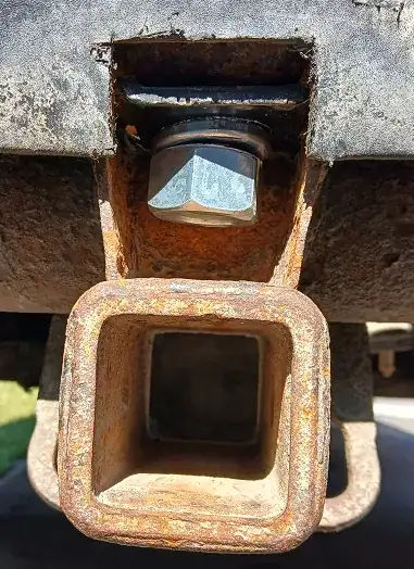

The hitch nut is located inside a tight area within the bumper.

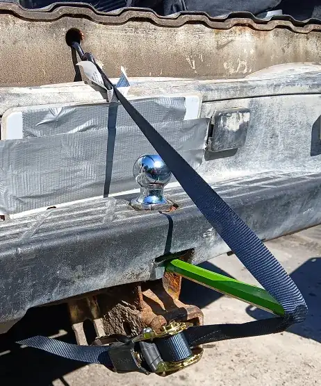

If I was using a proper drop hitch that wouldn't block the nut, I'd use 18-inch adjustable wrenches for both the ball and nut. But in this case, the adjustable wrench doesn't fit between the nut and the steel sides of the bumper.
I purchased a 1-1/8 and 1-1/2 in Trailer Hitch Ball Box Wrench. The 1-1/2" end would otherwise fit the nut, there is room on the sides of the nut, but not enough room at the back of the nut.
As a last resort, I jammed a chisel between the nut and the side wall. I need both hands for the adjustable wrench (otherwise, the wrench wants to slip off the ball), so I strapped the chisel in place using a ratchet strap.
That worked, but it made it awkward to use the wrench because the strap was in the way. Unfortunately, I don't have anyone to help hold the chisel.

I was able to use some needle nose vice grips on one of the steel sides. I jammed one of the jaws between the nut an the steel side so that the nut doesn't spin.
