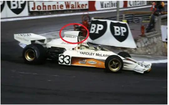

As I stated, the stacks are open from above, but they are still covered by a cowling. The cowling (marked by a red circle) covers this area during racing or even when getting ready to race.
racecar with cowling circled
This is why the liquid you see would not be water from rain. They only leave this area uncovered when there's an issue, if they are prepping it to run before a race, or if they are doing a post-race autopsy. In the movie, they are showing this area through "movie magic", as if the cowling wasn't there.
