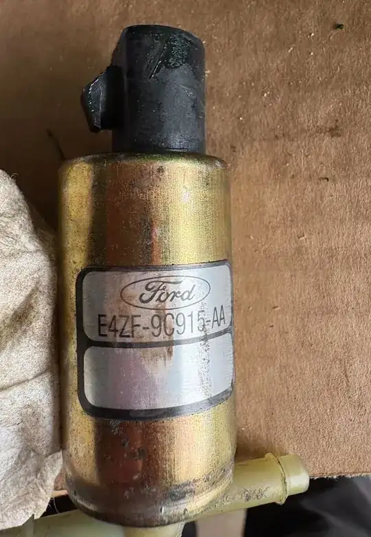

I've diagnosed that I have a bad purge valve solenoid, but I can only find parts for for a 1996 Ford Ranger 3.0. My understanding is that these trucks are identical except for trim, badges, etc. I've seen more than one parts store that has the ranger parts but not the Mazda parts. They look identical.
Are they really different? Are they interchangeable?

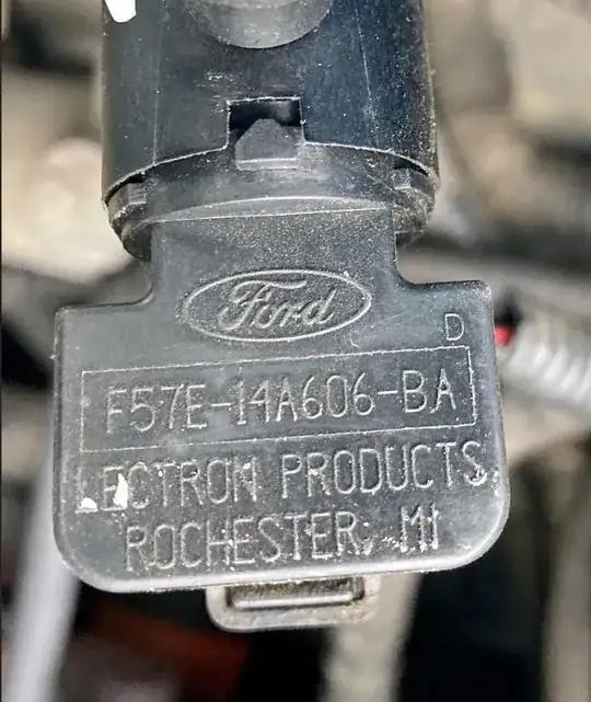

ford purge solenoid that works on B3000
These two Ford parts work fine in my 1996 B3000 and cleared my P01443 DTC. SMOG good for 2 more years!
