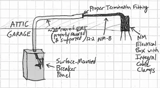

I was hoping to enclose 12-2 NM-B in EMT for about 20 feet from the breaker box up my garage wall and into my attic to protect it from physical damage as needed when running perpendicular to the joists in my accessible attic. Then, the NM cable would just run the rest of the way unenclosed and parallel to a joist to a non-metallic box with integral cable clamps to feed my garage door motor: enter image description here

After some reading, the interpretation in the question is correct.
In every edition of the NEC since 2002 when the clause was introduced, you cannot run NM-B in conduit for more than 10ft if the conduit run starts at a cabinet, cutout box, or meter socket enclosure -- this includes "breaker panels".
