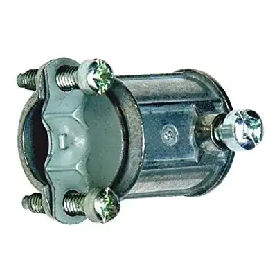

EMT to NM 1/2-Inch, 3/8-Inch Coupling To run Romex, non-metallic NM-B sheathed cable in EMT conduit use a listed fitting, as shown above, per the manufacturers instructions.
