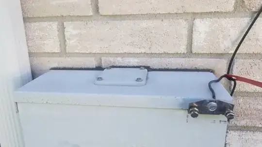

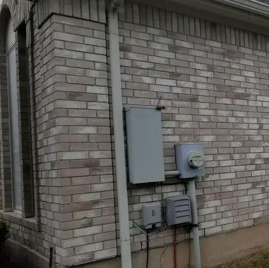

My panel has a ~2x2 square plate on the top. I don't know how to terminate the EMT in a rain tight method. Here's a picture of the top of the panel and general overview of the setup before I've done anything. How can I terminate the EMT in the panel and ensure it's watertight?

Running into the top of the panel is unwise
Running a conduit into the hub at the top isn't the wisest idea, to say the least -- that hub is intended to be used for a service mast with its attendant weatherhead to keep the rain out, not a conduit going up into a LB, and you can't have any other openings in the top, or else the box loses its NEMA 3R weathertightness rating.
Instead of that, I would use a box to transition to 6AWG THWN in 3/4" EMT in the attic, then run the EMT out of the house and LB the run down to a LR body that goes into the right side of the box, right above where the service wires go in. Also, put a 1/8" hole in the bottom of the LR to make sure that water can get out of it instead of building up and then going off into your panel.

Yes you can run the 6/3 into a piece of EMT, but you have to meet the 40% fill rule which I believe is a 2" conduit. You can instal a threaded hub where the 4" square is, but it must match the Panelboard Type (Sq D, GE, etc.). You will attach it with a Water type compression connector to the hub and, where the cable enters the EMT it must be bushed (they make a plastic ring for that or you can just use another connector with an insulated throat). You should also strap it within 2' of both sides of the conduit. I would use a small piece if 7/8" unistrut and 2" unistrut conduit clamps.
