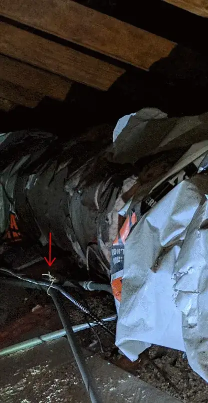

I tried to take some pictures, but my cellphone was not up to the task. This was about the only clear image I managed.Questionable wiring

I'll admit, seeing a twist-tie thing holding the cabling together is a little concerning. But I'm also surprised that none of this came up during the home inspection.

Having the flex conduit would raise concern for possible grounding issues (which I would recommend an electrician to evaluate). The NEC has been revised in regard to metal flex conduit as per max. length and another issue is concerning grounding; not that flex is intrinsically bad. Having wiring run over the joists would raise concern for having them damaged (which I would write up as a problem without needing an electrician to evaluate).

I suspect the electrician may be over diligent rather than practical in his recommendations. For example, if the flex is grounded sufficiently there may be no reason to replace. And the wires running over the joists could be protected by
a) installing parallel 2x4s, one on each side of the wires, and securing the wires to the top of the joists,
b) place a 1x under the wires for horizontal support, to which the wires are secured, then placing the parallel, standing 2x4's as above,
c) just one standing 2x4 and secure the wires to the side of it.
All of these suggestions prevent someone from "walking-the-joists" and stepping/tripping on a wire.
