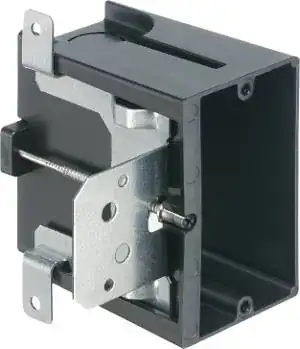

Since you say new construction you can get adjustable boxes if not from a big DIY box store then you can get them from an electrical wholesaler.
Adjustable box
If you use the box extender make sure what you buy has a UL on it, or whatever country you live in stamp of approval.
Here's the spec sheet on the adjustable box. Here.
