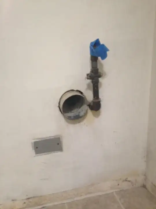

(Adding the requested photo here although it's a bit late. Note that I covered the hard-gas-line's opening with painter's tape and stuck it on/around the valve so you can't see it, but it's there. Wanted to protect it from all the lint and dust floating around down there.)
gas line; valve covered
