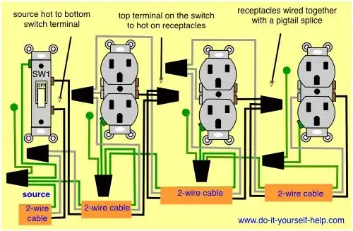

I know how I would go about wiring it. The diagram shows how the room is currently wired. What I will do is remove all wires from the switch twist the two black (live) wires together with a nut and remove the pigtailed ground from the switch (and the box). That leaves those outlets all normally powered without a switch.
This wiring diagram belongs to do-it-yourself-help.com. The original can be found here: https://www.do-it-yourself-help.com/outlet-switch-electrical-diagrams.html
Now my question is, can I just leave those wires in that box even if I am going to run wires from the light into that box, and to that switch? The light is powered from wires on a different circuit, so I will have two sets of wires from two different circuits running through that box.

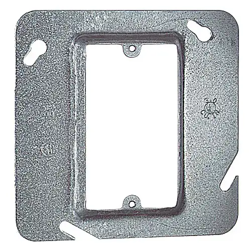

There is, of course, no problem with putting a larger box into the wall so that you have more room for all the wires and nuts you plan to put inside.
There might be a problem with the presentation of the finished work. You wouldn't want to put a double gang faceplate on your wall when you only have one switch.
The solution is to use what's called a plaster (or mud) ring. This could cover say, a two gang box and leave only a single gang exposed through the drywall.
