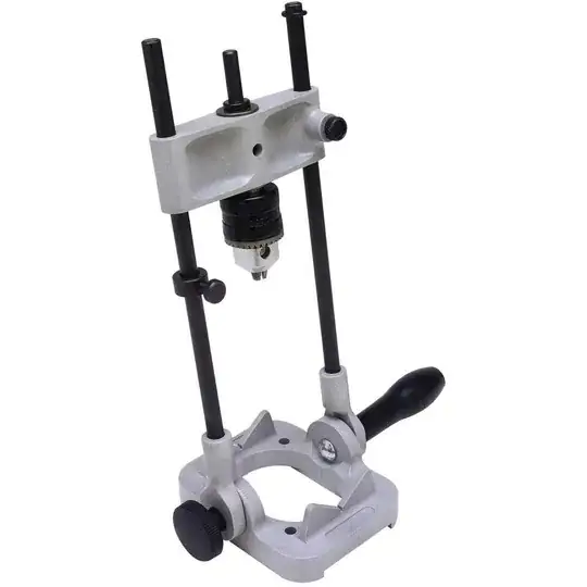

The scope of your project requires an equally large scope of preparation. Swap out the ladder for a scaffold system. Replace the hand drill with, at a minimum, a drill jig to keep alignment while you drill. Use drill bits designed for drilling plastic to prevent cracking. Your emphasis on avoiding splintering/cracking increases the importance of proper drill bits. Using such a small diameter drill bit also increases the chance of snapping a bit in the hole. With a combination of scaffolds, a drill jig and proper bits, you may be able to accomplish your goal.
representative image of drill guide
You suggest that the holes need not be perfectly straight, but a jig will enable you to drill in a safe manner to avoid snapping a bit.
