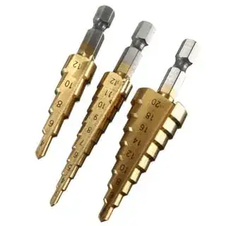

If you have some, you could use a step drill instead of a twist drill.

The step bit may also grab and crack is used incorrectly, that is inappropriate speed for the material, but it has a much smaller chance of doing so than using a conventional steel cutting bit.

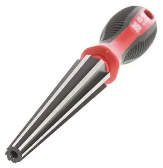

When I work with plastic boxes I find it best to start with a small pilot hole just like you did but I then use a hand tool that looks like the following. It works very well at shaving out the hole to the diameter needed. It is amazing how fast and easy this tool works in the thin plastic walls of a project box.
Some hand tools like this will come to more of a point allowing them to start in a smaller hole. The one pictured above may not be optimally pointed but does demonstrate another desirable feature. A tool with more flutes will cut a smoother round hole.
