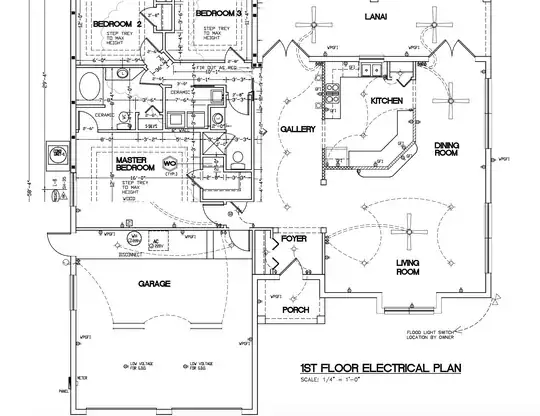

Electrical plan shows exterior receptacles on 4 sides of house. House is 250 linear feet.
Considering the voltage drop calculations here: What is the maximum 12/2 wire length from a 20A breaker to a baseboard heater?
What is the best approach for wiring these 4 exterior receptacles on the same circuit? What about running a 6-2 gauge wire to the center attic in a junction-box, then branching from that using 10-2 to all 4 exterior receptacles? Will that meet NEC code if i drop it in conduit from lintel-level to receptacle box?

The drawing is cut off and we can't see most of the exterior receptacles, but it looks like they're mostly on the far side of the building from the panel (lower left and I really hope the panel isn't outside, that's asking for trouble).
Your building is EDIT: 54x58, that's 76' on diagonal, plus 10' twice to get to the attic; 96'. That would be about 5.6% voltage drop at full 20A, or half that at 10A. If you strictly follow the 3% voltage drop on max current rule, you can only get 51' out of 12AWG... but that's not the rule. The actual rule is try to stay around 3% for the actual ampacity you expect to use, so for a 12A electric lawnmower you're a tick over 3% for a 96' run. No big.
Seriously, one guy strictly following the 3% fake-rule was about to install 600kcmil for his 1600' run to a couple of 10-watt post lights. I showed him how to do it with 14AWG.
Nothing says you must wire in a string all the way around the circumference of the building. You can wire a separate homerun for each receptacle. Or more likely, you can wire in a star configuration, or even more than one star.
For instance as you suggest, I would establish two "stars", one at the panel and one, about I don't know, the kitchen. I'd take each receptacle to whichever "star" is nearest. In some cases that might end up being a home run to the panel.
If you have 2 or more homeruns, you can either make them separate circuits or the same circuit, up to you.

What is the max length for a base board heater? There is no max length but there is a max voltage drop. Since you did not provide the load there is no way to help other than point you to the web voltage drop calculator. Easy to use input the info and it will provide wire size. Use 3% for max voltage drop. You are way over thinking the voltage drop, even with huge homes I have never used more than #10 and that is because the owner wanted it. You will have a hard time finding a 20 amp breaker that is listed for #6 wire.
