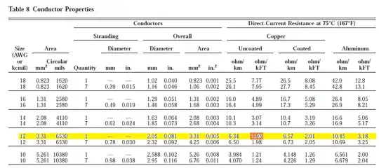

To calculate the maximum length of the circuit, you'll first have to know how much resistance the conductor being used has. Table 8 from Chapter 9 of the NEC, makes this simple. If you're using 12 AWG solid uncoated copper, you'll find that it has a resistance of 1.93 ohms per thousand feet.
Table 8
For the following formula, you'll need to know the resistance per foot. This is easily calculated, by dividing the value above by 1000.
1.93 ohms per 1000 feet / 1000 = 0.00193 ohms per foot

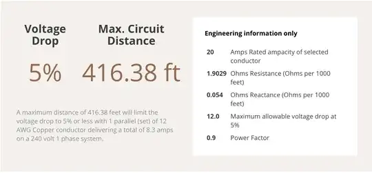

Our friendly neighborhood Southwire voltage drop calculator says the following about that with #12Cu wire:
Heaters ae extremely tolerant of voltage drop, so there is no trouble at all using 5% or even 10-20%. But even if we went 3%, the answer would still ge 250' or so.

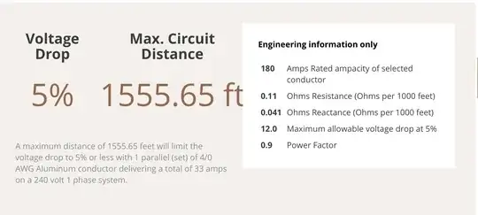

Imagine you have four of these guys running, for 33A, and you have a nice fat 4/0 feeder. What does the voltage drop calc say now?
So even at 300' that would be 1% drop. And I'll bet you 4/0 Al is cheaper than you were prepared to spend on copper.
