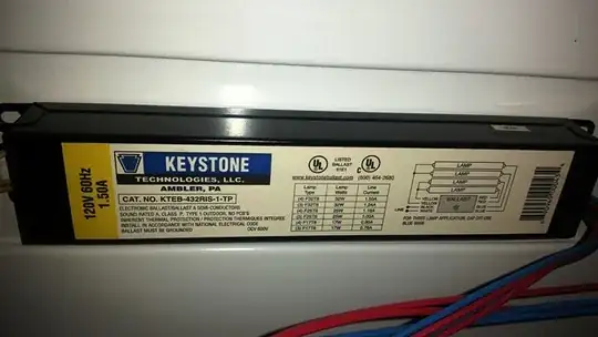

I am new to Home Improvement and recently hear a pop!, then my overhead lighting in my small kitchen stopped working. Lowe's sold me a replacement ballast (good enough to remove the old ballast, and attach the new commercial one which the associate said would work fine), and once reinstalled, the one bulb was killed outright, another flickers nonstop and is very dim, and the third seems okay?
It never did any of this before, and I am concerned. Before getting gouged by an electrician, I was hopeful to ask for insight here.
Thanks enter image description here

Those look like 48" bi-pin tubes (the most common one). From looking at the "old" Keystone ballast, your old ballast was for F32T8 tubes, 1" diameter (T8). Which means it's not that old. Don't use F40T12 tubes, 1-1/2" diameter, they will fit but they are not electrically compatible unless you change to a T12 ballast.
Look at the existing ballast

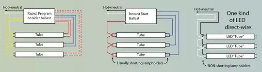

The big label on the old Keystone ballast says your bulbs are instant-start, with 1 wire per end of the lamp. Gotta watch out for that 2-yellow 2-red 2-blue color scheme as it's also used by 2-lamp rapid-start ballasts. This is an example where the diagram really matters.
Check the new ballast also, the wiring may be subtly different. If the Lowes clerk picked your matching ballast by the same wiring diagram, that's handy, but double-check the type of tube it's made for. Here are generic drawings of ballast wiring; yours may vary. For instance yours wires like two separate 2-tube instant-start ballasts.
enter image description here This is from my big answer here.
