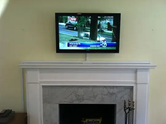

Use a wiremold type product to surface mount the conduit:
There are lots of different brands, and it can be paintable. With planning, you can minimize where you see it.

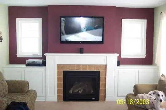

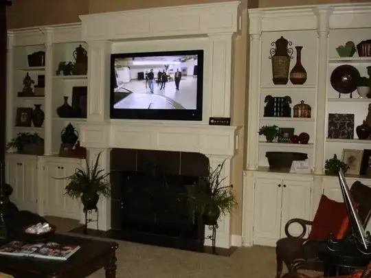

Build up the wall using cabinets or a false wall, so you can run wire in behind, on top of the existing wall.
Could be as simple as just a drywall section sticking out, or some built-in cabinets or some brick work. Cabinets of course have the benefit of being able to build in other components such as your A/V gear and speakers.
