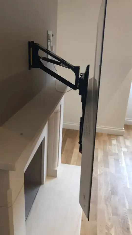

Ideal solution would be a pull down tv mount like in the image, its called Tranquil Mount TMO400B or TMO100A
drop down tv mount

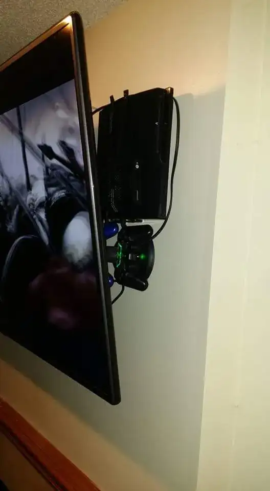

enter image description hereI been having the same issue, the 60" had to go over the fireplace, it just had to... The PS3, and cable box, and PS3 controller charger had to be hidden, I'm usually a laid back guy, but when it comes to my TV I'm pretty OCD about not having wires showing, and everything being clean looking, so I mounted everything behind the TV itself.
I have enough room to place a mantle, but I really don't want anything my 3 year old can hang on, and or break!
So this is my idea..
A computer fan piped into a custom vent that spans the whole bottom of the tv and acts as a passive heat shield, and when the tempature sensor is triggered, the heat fan comes on to be a active heat shield, plus it will distribute heat throughout the room as well.
Genius..? Yes it is. But, turning this idea into a reality is a little daunting, finding the fan is easy, but how do I hook up the tempature switch to the fan, and what to use for a almost invisible vent that can double as a passive heat shield that barely protrude from the bottom of the tv, I'm thinking it would only need to be a 1/4" thick slit spanning across under the tv, and could be mounted to the tv, or backing plate so if I pull out the tv on the swing arms(adjustable tv mount), the fan and vent will move with it.
Any ideas for what to use would be awesome, I know there is some critical thinking/practical application people out there.
