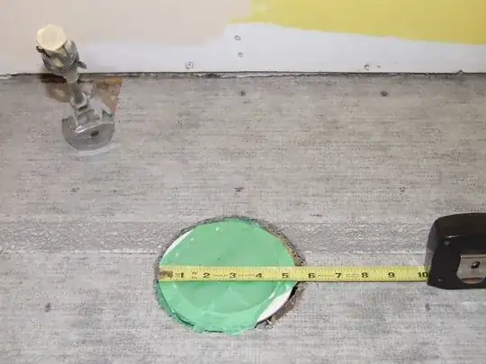

I am about to tile a bathroom floor. I was dry-fitting some concrete board when I realized I don't know how the toilet will reconnect once the floor is higher.

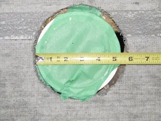

Concrete boards dry fit on floor with toilet pipe
The old floor was a thin layer of vinyl adhered directly to the subfloor. The new floor will be roughly 1/8" thinset mortar + 1/4" concrete board + 1/8" thinset mortar + 1/4" tile. So almost 3/4" higher than the old floor.
The PVC toilet pipe is 4" interior, 5.25" exterior.
Toilet pipe from above

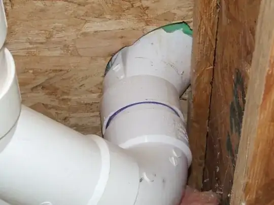

The bad news: it's an offset, something like this.
Offset toilet pipe
It had a broken metal flange permanently attached to it. I have already broken away the flange.

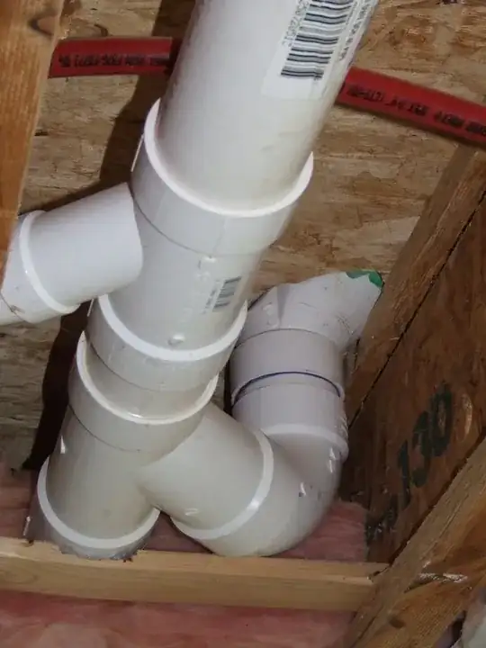

I feel like I should cut the PVC below the subfloor, and reinstall a new offset valve higher than the old one. But space is cramped beneath the floor, and I'm afraid I'll make things worse.
Toilet piping below floor
Toilet piping below floor close-up
I saw some videos online about separating PVC with extreme heat, but I'm afraid of igniting my house or sewer gases (I have a septic tank) or both. I have minimal PVC experience.

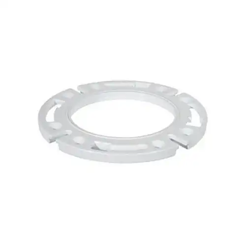

What you are looking for is a riser also called extension flange. But considering you are able to get to the pipe below - you could just extend it to what you need, but cramped space and a crappy job - and possibly not being able to seal it properly well - could be really ...
Humor aside take a look at the links here I think you will find it to be easier.
I do believe they make spacer flanges in @ 1/2 and 3/4 inch increment.
See this link Extension Flange
There is more detailed information provided here for 4 options but extenders and spacers are straight forward and simple.
Extension Flange

Plumbing trick...You are basically going to make a coupling out of 4" PVC pipe. Cut 3" pipe below the floor even with the top of the hub on the 3" elbow. 4" PVC pipe will fit perfectly over the 3" hub at the top of the elbow. Glue 3" hub to the inside of the 4" pipe. Next, your "new" offset flange hub will glue into the 4" pipe.
