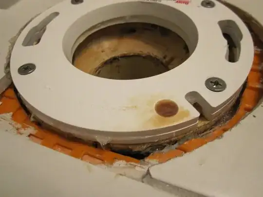

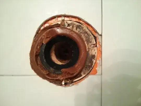

I used two wax seals to set my toilet since the flange is 1/4" below the new tile. At first it seemed to be water tight but after a few flushes I noticed water seeping and pulled it out. As can be seen in the photo, the wax ring slid off center. I couldn't use just one ring since it protrudes about 1/4" below the toilet so that would just barely touch the flange. I found the flange extender in another post and will try that. One of these
So to my question. Is this the correct approach? Should the flange be level with the floor prior to installation?
Edit: The correct height of the flange is sitting on top of the finished floor. Of course with a remodel this is almost never going to be the case after tiling. There seem to be various methods to raise the flange. Many say the double wax ring is problematic since it can collapse into the drain over time. This link discusses a number of products to solve the problem. In summary, the set-rite (~18 + shipping) is the most expensive and apparently the only code approved product. The cheapest option is flange extenders ~$3-5. The funny thing is neither the tiler or the plumber that worked on my bathroom mentioned anything about the height problem, which leads me to believe the common solution is the double wax ring.

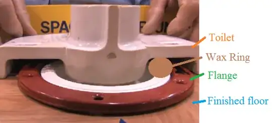

The flange should sit on top of the finished floor, if it doesn't you'll have to modify the plumbing or find another way to achieve this.
Proper toilet flange
Notice in this image how the toilet waste pipe sits just inside the flange opening, this is the proper way for a toilet to sit on a flange. Even without a wax ring, this union is not likely to leak under normal circumstances (I'm not recommending a wax ring not be used).
Wax as a waste pipe?
Some folks recommend using a thicker wax ring, or even doubling up wax rings. The problem with this, is that you end up with a waste pipe made from wax. Now this might hold up, but more than likely it's eventually going to fail, and leak.

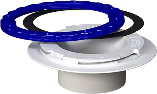

Adapters
There are adapters available, that solve this exact problem. The [Set-Rite Toilet Flange Extender Kit]; described in the answers to this question, Comes with different size spacers, which allows it to compensate for various sized offsets.
Edit: Original link broken, so screencap photo inserted instead: enter image description here

I was 1/2" below where it should have been so I used two flange extenders to get the flange 1/4" above the finished floor. They are siliconed together and wax is the seal between the original flange and extender. Although many seem to recommend silicone, it would have been too much work to get off all the old wax so I used a few gobs of new wax.
I did the same for another bathroom but only needed one flange extender. That flange was not level so I ended up with nylon washers and copious amounts of silicone to seal and level

`enter image description here
I talked to an employee at Lowe's and he recommended Culwell Flange.

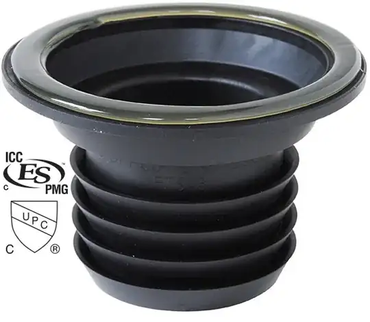

This may be similar to other products mentioned but in case - this brand is easy to find in the US, inexpensive, and worked for me:
http://www.fernco.com/plumbing/wax-free-toilet-seal
wax free toilet seal
You do have to buy the right size to get a good seal with the pipe below. Also, you have to make sure to thoroughly clean the surface where the adhesive attaches to the bottom of the toilet so all the wax residue is gone - I used brake cleaner to make sure, because I didn't really want to do this job once, I definitely didn't want to do it twice.
