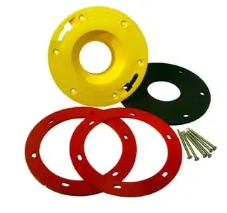

A double wax ring will probably work but IMO the better option is a toilet flange extender. It is just another flange ring that sits on top of the original flange to get it up to the correct height. Then you install the wax ring and toilet as usual.
I don't have any experience with this particular kit but something like this Toilet Flange Extender Kit.

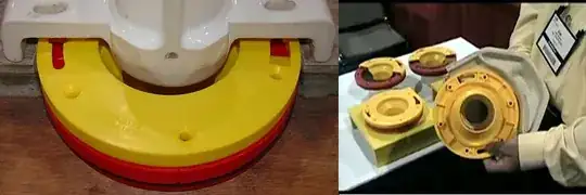

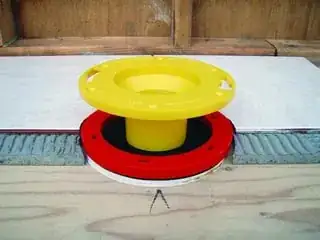

I have used the Set-Rite Toilet Flange Extender Kits for almost 5 years. They work great. Doubling up wax rings is okay if you want to make your waste line out of wax! These kits have a regular extender toilet flange which will bring your installation to the correct height n top of the finished floor.
Here is how your toilet flange is supposed to look and as you can see all you'll ever need is just one standard wax ring:
Set-Rite Installed w/cross sectioned toilet base
They have a couple of videos on YouTube that will help with your install and also have an email & phone support for the DIYer.
Good Luck, but you won't need it with these kits; it's an easy job.
