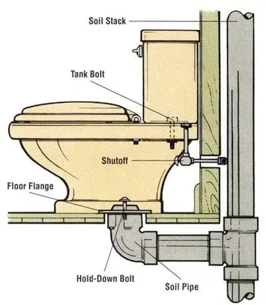

What are the best practices or other rules such as building code regarding how to set the height of a toilet flange relative to the finished floor height?
Example of the type of flange I am referring to: enter image description here
I have read conflicting information - some statements that the top of the flange should be flush with the finished floor, others that the bottom of the flange should rest on the finished surface.

The original intent of the toilet flange is to screw down to the finished flooring, not below it, definitely not shimmed up above the finish floor, although there is a small bit of room if there is a small error in the install, say no more than 1/8"-1/4" Remodeling has made it a regular practice of setting the flange below a newly installed finish floor where the toilet was already in place. Larger (taller) wax rings or doubling get past that issue. And with that in new construction, setting the flange on the subfloor has become acceptable, also setting it below the finished floor.
