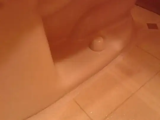

This is the resulting appearance: a very thick, prominent, grout line:
toilet raised about 5/16" or 8mm using sanded cement grout

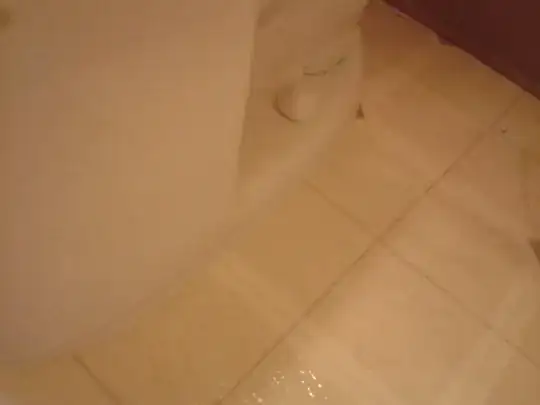

For comparison of grout bead size, here is an identical toilet in another location, also grouted with the same material, but which is not raised. This toilet already sat on the floor, before the grout was applied, which was done for cosmetic reasons and any additional stability it might provide.
toilet which sits flat on the floor, grouted with sanded cement grout
