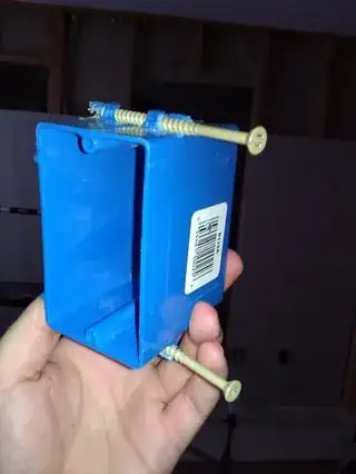

Ever since I dove into the electrical side of things with my project, I've encountered a bunch of code restrictions. One thing that wouldn't surprise me if it was a violation of code is what I've done here:
modified electrical box
I did this because I have to install five of these things and don't want to disturb my neighbors. To get the screw to fit without breaking the tabs, I drilled through them with a 3/16" bit. The screw goes through with just enough snugness to hold on to the plastic with the threads, but not too snug that it bends or breaks the tabs. I did a test install on a stud and it holds really tight.
I did this because I couldn't find any screw-in receptacles at the hardware store that would allow me to bring the face of the box out 1 1/4" inches from the stud so that it would be flush against a double layer of 5/8" drywall.
Update: Crap. This is not going to work. I need to bring it out too far from the stud. When I go to install the drywall, the drywall is going to run into the mounting assembly. I need a box with the assembly in the back. I won't delete this question, though, in case it will help someone else who is not trying to add one million layers of drywall.

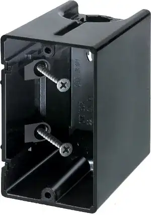

Here's another type of adjustable box that you can use. Just mount the box approximately where you want it and after you find the correct depth you can move it, even after drywall has been installed.
F101
Here's the cut sheet on it. Here.

For the record, they make adjustable depth junction boxes like this.
They allow you to mount the box to a stud, and then adjust the depth at which the box sits on the stud.
They also make Old Work boxes, that can be connected directly to the drywall using clamping tabs.
The tabs pinch the drywall, and hold the box in place.

It is very plausible to have a box which allows nails but not screws. The general code requirement is that devices be installed as specified under their UL listing. The tabs that fit the nail or screw might not be thick enough (just guessing since I don't have the box or can see its UL listing report) to handle a screw. Screws too small would not hold it firmly and screws too large might rupture the tab. Because screws do have threads, there may not be a sufficient sweet size of screw that works just right. But I do know lots of boxes work fine with screws, as produce illustrations do show (here, and many other places). It's a matter of making sure you have a box rated to use screws (and, of course, use the size it is rated for).
I like lqlarry's box.

So I came across this answer when I was trying to fit a difficult install. I note the box that I used:
https://www.homedepot.com/p/Carlon-1-Gang-24-5-cu-in-PVC-New-Old-Work-Electrical-Box-B125AB/305110267
Has internal spots to drive nails or screws in the same way as the box pictured in the first answer.
I was trying to fit a box that faced outwards to an outside wall, and most of the nail in type boxes have front facing nails that can't be used if you are fitting to an existing wall. The above box has the nails at the rear, which solved my issue, but also has these internal nail/screw holes that can solve other issues as raised in this thread.
