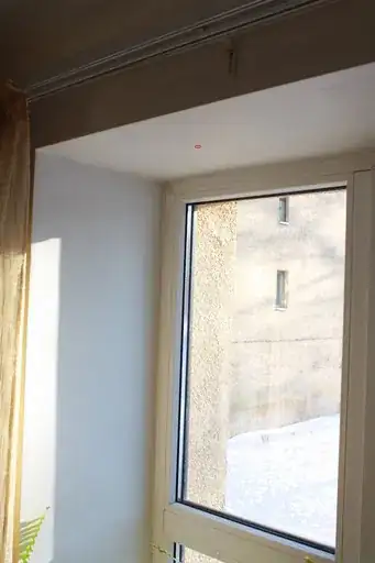

I have a potted plant (approx 5kg/10lbs) that I wish to hang from a drywall ceiling of a window aisle.
Unfortunately, I have no idea about what specific kind of drywall plate it is or how it was attached; at any rate there is only a fixed place that I can hang the plant from so that it doesn't prevent me from opening window.
I have previously attached shelves and all kinds of things to drywall WALLS, no problem, and also reading here I mostly found about attaching/hanging things to/from walls, too, but I am a bit concerned about how much would a drywall plate be able to hold something hanging straight down from it.

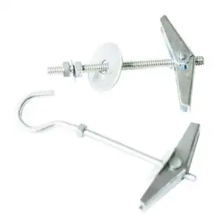

My current idea is to use a metallic threaded anchor like this:
but maybe I need several anchors just to make sure weight is distributed, or maybe I should use a different kind of screw/attachment?
THe aisle in question:
Window aisle

Ideally this should be screwed/anchored into a joist for maximum support. However, if you really want to use a drywall anchor, you should use a toggle bolt or a ceiling anchor. Instead of just screwing into the wall, these expand to several times their size which gives you a good hold, especially when the force is pulling directly down. 10lbs might be pushing it though, it will depend on the thickness of your drywall and the overall condition. The worst case is you just have to patch the hole and repaint; drywall is pretty forgiving like that!
Toggle

That said, a typical toggle bolt on standard drywall is rated for 150 pounds. I do not trust that rating, but that is the rating none the less. I think toggle bolts are fine for 10 pounds.
