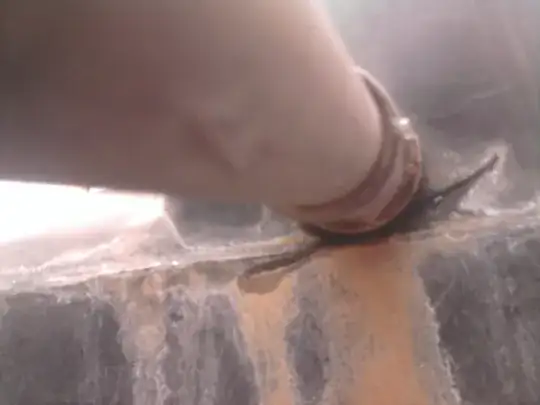

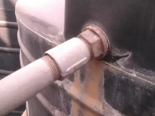

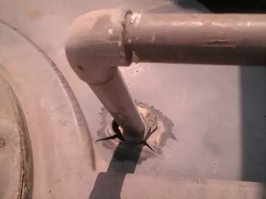

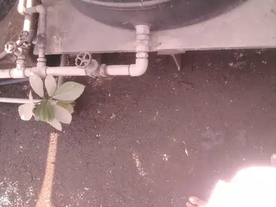

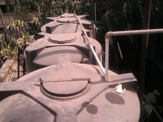

I have a leaking water tank here in Bombay, India. I'm looking for suggestions on how to repair it.The tank is a plastic Sintex water tank. There are cracks around a water pipe running into the side of the tank. I am looking for approaches to sealing the leak. I believe soldering/welding is one option, but I think using some kind of sealant on it might also be an option. Opinions on the pros and cons of each approach would be helpful. Specific recommendations for sealant would also be helpful; I'm not sure what to look for. Here are some photos of the leak. In order, they show:
  • A row of tanks.
  • The pipe leading to the leak.
  • A closeup of the pipe leading to the tank.
  • A closeup of the cracks in the tank areound the pipe.
  • Another closeup of the cracks.
A row of tanks. The pipe leading to the leak. A closeup of the pipe leading to the tank. A closeup of the cracks in the tank areound the pipe. Another closeup of the cracks.
