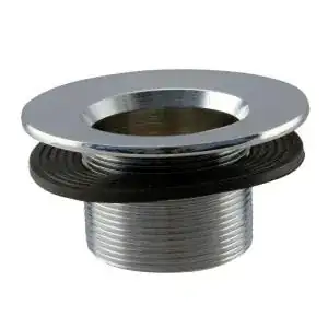

I haven't seen one for a small diameter pipe, but what you're looking for is some type of drain flange:
drain flange
The top is wider to hold it in the opening, the rubber washer is below to seal the connection, and then you use a metal washer and a nut to tighten it to the surface.
With a small diameter pipe, you can improvise this with a threaded pipe and a second nut (pardon the ascii art, this is a cross section view):
                nut  ===|     |===
      rubber washer ....|     |....
  surface --------------|     |--------------
       metal washer ....|     |....
                nut  ===|     |===
                        |drain|
The downside of the improvised version is the nut and threaded pipe will sit up a bit from the bottom, so this doesn't work as well if you need it to drain completely to the bottom.

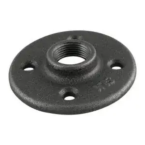

You could attach a flange to the outside of the tray under the hole. flange
(The flange shown would be turned upside down for this use, with the flat side pointing up)
The flange can be attached using bolts with the heads on the inside of the tray and nuts under the flange. Seal the flange with silicon sealant. This does require a threaded pipe, but these are generally available at home centers.

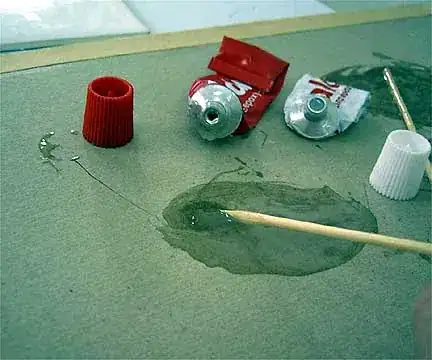

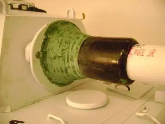

I am not entirely sure what you would like to do but you can attach almost anything with steal putty or epoxy resin.
Steal putty
Epoxy Glue
Both of which require to mix two parts into a single part (usually in equal parts) and they are non-toxic (but check the package before use)
You can either mould over or around the pipe glueing it to the surface or sealing it water tight.
