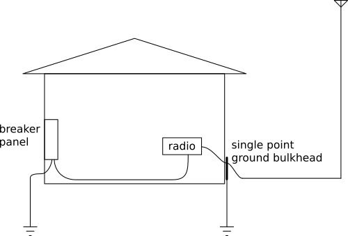

If I naively plug the radio into the wall, I have this situation:
The problem here is with a nearby strike there will be a large voltage gradient between the two grounds. That voltage appears across the radio, and things go boom.

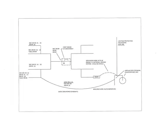

Alright let's try and get a little deeper. Sometimes a little sketch helps. enter image description here
This image is very primitive grounding schematic showing the usual methods of grounding and includes the proper way to connect to the antenna. Also note that the NEC does not cover antennas and lighting protection that is found in NFPA 780 and IEEE but I don't know which section of hand.
Everything must be bonded back from the antenna prior to the bond at the first means of disconnect. As I have said before this is to provide as much dispersion of the strike into the ground, and then if you have installed a surge protector it will suppress the strike trying to make its way upstream either in the power lines or in this case the ground.
If you connect the radio or any other equipment attached to the antenna ground after the bond at the first means of disconnect, then you have bridged the surge protection and left your entire electrical system to the full force of the strike. The only other thing I could think of is that you might be thinking a shield is a ground to the radio (like the outer protection of a coax). But a shield is a drain that bleeds off outside induction and frequency interference. It should be attached to the ground on one end but is left ungrounded at the other ergo it is not a ground. If you say it is impossible to unground the radio from the antenna then you must not attach it to the building ground and make it a separately derived system.
