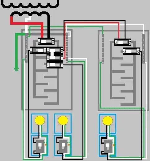

If the main service panel happens to be the same place that the grounded (neutral) conductor is bonded to the grounding electrode, then there is no problem mixing grounds and neutrals on the same bus bar (as long as there is an appropriate number of conductors terminated under each lug). If the two bus bars are not connected; as would be the case anywhere other than the main disconnect (exceptions exist), then you cannot mix them.
Service Wiring
Notice how the grounded, and grounding bus bars are connected in the main service panel. This means that; electrically speaking, they can be considered a single bus bar. Which means that both grounded (neutral), and equipment grounding conductors can be terminated on either bus bar.
In the subpanel, the bus bars are kept separate. So grounded (neutral), and equipment grounding conductors cannot be mixed.
You can just use whichever bus is easier to get to in the main panel since they are wired together, either with a large wire, or they can be physically the same piece of metal.
That being said, any electrician who take pride in their work will make sure that all of the neutrals run to one bus-bar, and the grounds the other.
Also it makes it so that later down the line, you can add a new panel as the main one, using the old main panel as a sub-panel without a lot of rewiring.
