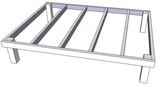

putting the legs on the inside will induce a shearing load on the connection. A better connection would be having the wood frame rest on the leg (with a notch). You also need to account for the needed strength in the corners so everything stays square.

Your design has lots of shearing at all joints. A better design would to be rabbet or dado the edge rails and let the slats in that way. Alternatively you can just place the slats directly on top of the perimeter and center rails. Likewise for the legs, either build a plate for the leg to push on, or use 4x4s and notch two sides. (I actually prefer the design where the 'legs' are bookcases and go the full width.)

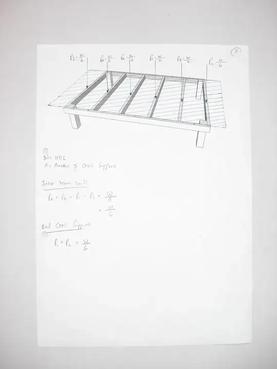

[Case A]enter image description here

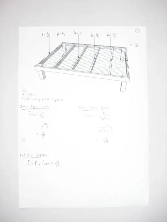

[Case B]enter image description here

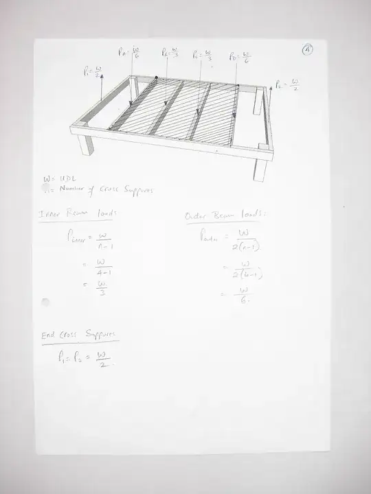

[Case D]enter image description here
