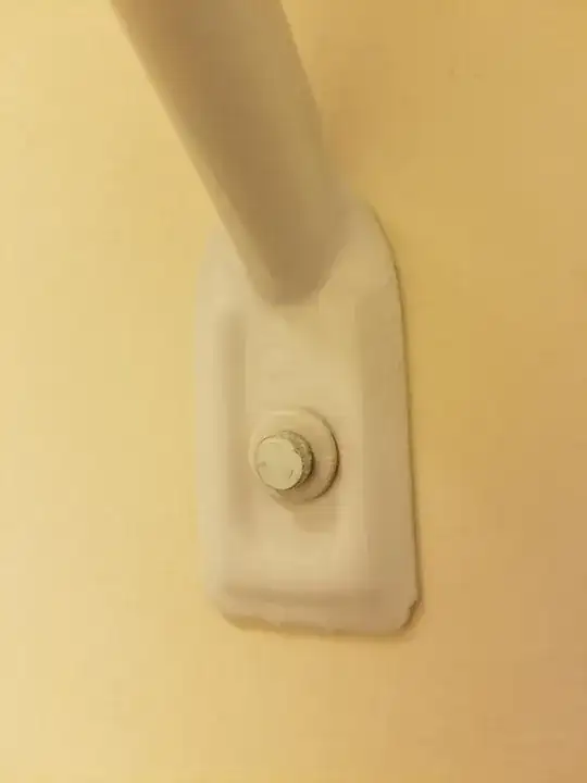

I have some shelving in my closet and it's screwed into the wall with fasteners that look like this (see image). It's a smooth circle and doesn't have any type of hole of slot on top. Is this a screw? If so, what kind of screw is this and how do i get it out? I want to take this shelving down!

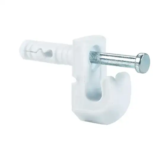

That's an expanding plug anchor as is commonly supplied by closet system manufacturers. Pull the nail out by the head (a locking plier works well), then pull the plastic plug out.
Here's a representative item:
ClosetMaid has a blog post on removal.

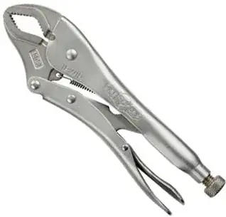

Get a pair of vise-grip locking pliers:
They clamp down and can turn ANYTHING. I used them to remove some one-way screws. Just be careful never to try them out on your fingers, unless you like the idea of having your bones replaced with metal implants.

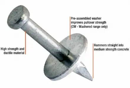

That looks like a ramset fastener (fancy schmancy powder-actuated nail) to my eye, not a screw at all.
If you can't pry it out, you'll probably have to grind it off.
Ramset nail
Feel free to apply locking pliers to grab the head very firmly and wiggle it, but I sincerely doubt it will unscrew.

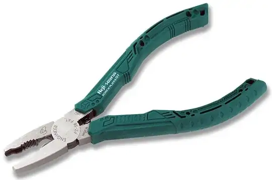

This is most likely a plug like @isherwood suggests - nothing new there. I'm adding an answer to recommend a tool. If the OP doesn't happen to have a pair of vise grips on hand, a pair of screw pliers is in order:
These are a bit of luxury, but work like a champ, and are the perfect tool here. I picked mine up for about $20. No regrets- works great for stripped screws, too.
