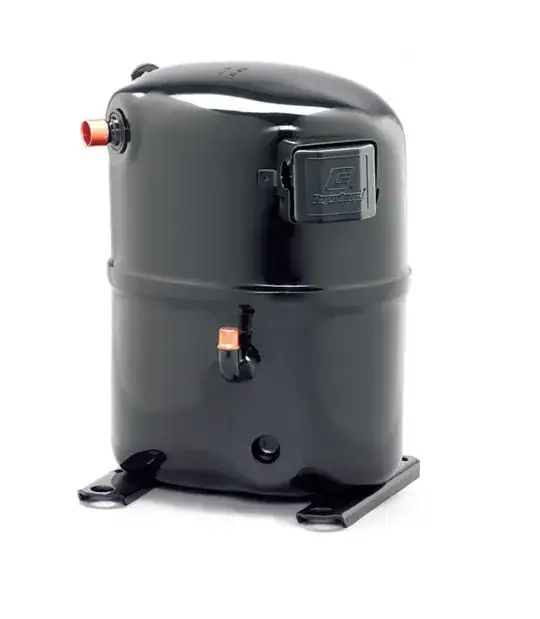

In an effort to double check, I took a look at the outside unit, turned off the power to our unit, lifted the fan and I noticed one of the wires going to the compressor is disconnected (the wire connecting to the bottom circle-like opening in the picture below). Additionally, all but one of the screws holding down the fan to the outdoor unit are missing, so running the fan, causes strong vibrations.
The exact model/brand of our compressor (different than shown below) is a Copeland CR42K6-PFV.
