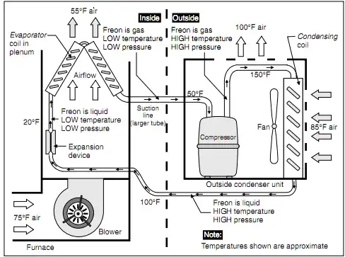

Here is a really good image to visualize how it works.
