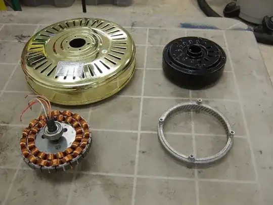

Motor Windings (stator) Most of the noise comes from the ac current running through the windings (copper wire on the stator) . noise will come be generated from the ac frequency vibrating each strand slightly (to the hz of the ac pattern)... there is a technique called dipping, where these coils are coated in a non conductive epoxy or tape, where the noise profile is improved substantially. (this would not a recommended solution since its quite technical.. just added for information see Epoxy Resin for motors

You are right that at very low revolutions, the main noise is the power hum. I tried to solve this for years, and eventually realized the hum is actually not the 50/60 Hz of the mais: that frequency is very low and can not be easily heard. What you hear is HARMONICS, the higher, audible overtones created by the distortion of regulator, when chopping small bits of the mains power wave. Solution was filtering the mains by a so called LC filter: basically, an inductance used in bar fluorescent lights as ballast (just any size will probably do), in series with a motor running capacitor (edited: not a starting capacitor). 4 uF value in my case. The filter is connected in series with the fan itself. The filter also substantially reduces the power that gets to the motor in proportion to the capacitor value, serving INSTEAD of a regulator. You can add a switch to short circuit this filter to get the fan back to full power in daytime.

But first, lets say you are using the 3-speed switch that was designed for fan, and that it is properly designed (bit assumption, but looking at best case first). In that case, its the pure 60Hz (60 full sine-waves/second) current. In this case, you need to smooth out that out (with result of slightly less fan power though that's usually not noticeable). To do that, use a capacitor. I'm looking at one I salvaged off of a good (no audible hum) floor fan that died after 15 years of use. I'm hoping to transplant it onto a Chinese special that has both vibration (physically caused) AND hum. I can't find evidence that it contains a capacitor, so I hope for it to be a good test of this relatively easy fix.
The capacitor is rated at 4 µF (microFarads) with a max voltage of 250V (@70C). A capacitor buffers current -- on each side of zero (since AC current goes from 0 -> 60V -> 0 -> -60V ->0). When circuit is high, will buffer positive and as switch goes negative, capacitor will bleed off and slow the change such that the peaks will be lessened and change will be slowed. The result: with less force generated by current changing direction more slowly, the hum will lessen, possibly becoming inaudible.
The fan unit I salvaged this from put the capacitor on the same 2 poles that led to the power switch in parallel with the switch.
