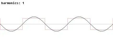

Here's an animation from wikipedia, showing a normal sine wave, and then the effect harmonics have on the overall signal:
In an AC motor (simplified explanation) the sine wave directly runs the magnets in the motor, causing it to spin. The harmonics effectively reverse the polarity of the magnets mid-rotation - it's as if you're flicking back and forth between forward/reverse hundreds of times a second. I believe this is what causes the hum.
As for why your tower fan works, hard to say. The motor design may be less susceptible to the effects of harmonics, it may have electronics built into it, or they may be DC motors.
