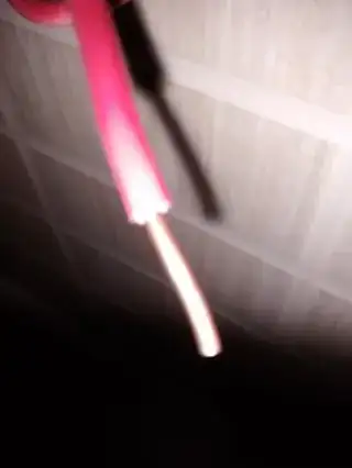

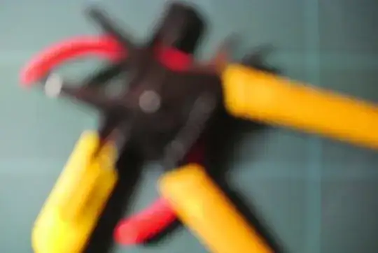

I use a small cutter made for max 14 gauge wires, but I'm bad at removing insulation, it takes me a bit of time to get it right, so I end up cutting and repeating, because I see scratches on copper wire were I cut the insulation. Should I ignore it? How bad are these scratches or marks? These are power works behind sockets.

Minor superficial marking is just that. Unimportant. Deep nicks around the circumference create weaknesses. Those would cause problems. Redo.
With the right tools, careful use and a little practice, you will be able to strip insulation without nicking or scratching the copper.
Blurry photo
Suitable tools, in the same spirit as photo in Q :-)

It's not you. It's the piece of junk wire stripper. There are a LOT of really terrible wire strippers out there, either in the $5 tool bin, or they come with variety packs of crimp terminals.
If you only have occasional work to do, take WGroleau's advice and roll an exacto knife around the edge of the wire, pressing just barely enough to penetrate the insulation, not nick the wire appreciably.
Otherwise, go out and buy a really good one. We're talking $12-15. Irwin is the lowest quality I would consider, and not their bottom-end unit either.
It should have a mystery hole about 1/4" from the edge of a side. Bolt shears are nice but not necessary. Having a terminal crimper is usually the mark of a junky cheapie, though it's perfectly possible for a fine tool to have it.

Small scratches should not affect conductivity of the copper wire at all. This is common when stripping wires bare with knives, side cutters and other misc tools. When one is preparing copper wire they should get into the habit of using wire strippersthis particular tool strips wire to gauge minimizing damage.

Also like @Harper says, make sure you have good wire strippers. Try about a dozen times on some extra wire, if you are not getting the hang of it, then maybe you should consider the tool then. If it's the red cutter tool with screw, make sure that the screw has been set properly for 14 gauge. If it's the yellow tool with multiple positions, then make sure a) you're actually doing 14 gauge wire and b) the wire is going into the 14 gauge position and not its 16 gauge neighbor. It is possible to strip with the 16 gauge position but will usually lead to bad results.
