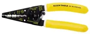

This is the stripper I use:
alt text
It's got cutouts for 14-2 and 12-2 NM cable sheathing and inner conductors, and a decent set of sharp bypass cutters near the hinge for cutting wire. It works better than anything else I've used for 14-2 and 12-2 Romex -- just squeeze, give it a little wiggle for good measure, and the sheathing pulls right off. It's almost impossible to nick the conductor insulation inside. For 3-way wire it's not so foolproof -- I use the cutter blades close to the hinge to score around the sheathing and then pull it apart. Probably as good as any other method and is still faster than doing it manually with a knife.
They also make a 12/10 gauge version and possibly others. I got mine at Lowe's.

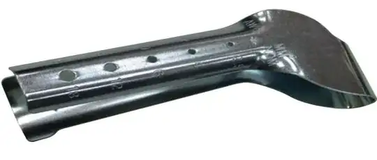

I've always had good results with a Wire Ripper like this, for removing the sheathing. Simply slip it over the cable, squeeze, and pull.
Wire Ripper

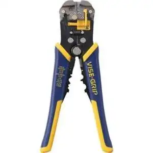

I use a self-adjusting wire stripper
Dead simple to use, and way faster than a manual stripper in my experience.

For stripping the individual wires, use the tool that James Van Huis recommends -- it's an awesome tool. With that tool, you'll consistent strip lengths and no knicks in the wires.
