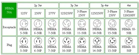

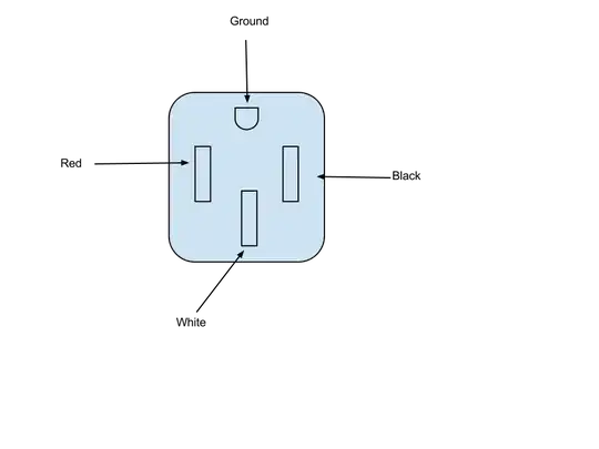

See NEMA 14-50R
NEMA 50A Table
Source
G - Ground
W - Neutral
X - Hot
Y - Hot
