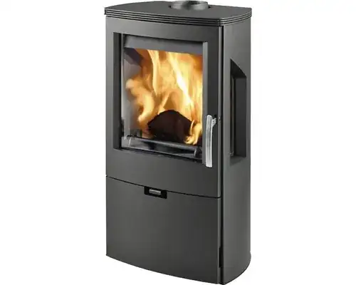

I want to mount a cast iron wooden burner like in the image close to the wall (a double wall with the neighbours, not an outer wall), at about 25-35 cm distance. The exhaust pipe runs vertically.

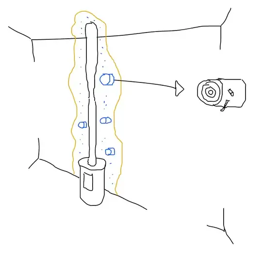

I would like to mount on the wall behind the burner a thin wooden panel (3 mm), fixed with screws to the wall, on which I will fix round cylinders of wood, to make a sort of artistic thing, and also to hide the darkening of the wall due to increased air movement and to the ashes that may in certain conditions escape. The fixing is likely to be done with some sort of heat resistant, low VOC glue, so that I don't have to remove the panel to add them.
It is important that the resulting structure stays flush to the wall, without bending due to age or heat, so that the short wooden discs/cylinders will appear like glued directly on the wall. The reason for the panel is only to allow simple removal of the structure in the future.
The panel would be quite full of wood cylinders 10-15 cm in diameter. They would be added in time, whenever available.
I attach a sketch.
The wooden burner is very hot and cannot be touched with the fingers on the top and top-rear, but the wall is only warmed by the radiant heat. The piping is also quite warm to the touch, but not hot (double walled).
