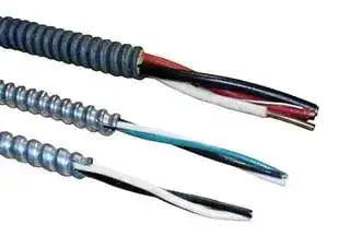

First off, there are many types of armored cable, most of which are colloquially called "BX". By "older BX" I assume you mean something like the wire at the bottom of this image:
Two conductors, no ground wire, no bonding strip. This kind of wire is an older design predating the grounding requirement. If the wire is original to the house, it was not designed to have the armor grounded (because it's 20 years older than the NEC grounding requirement itself). It's still available (hence the newer PVC insulation and overall new condition of the wire in the picture) because there are still situations in which it can be used safely (and jurisdictions that don't care); however, your situation and location probably falls under neither of those.

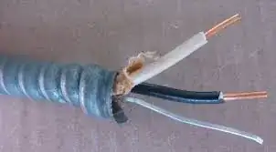

Nowadays, type AC cable (modern "BX") looks more like the following:
Notice the bare wire. This type of cable is designed specifically to have its armor and this "bonding strip" form the ground path in combination. You do still have to be careful about what you connect it to:
  • The bonding strip may still be aluminum, as in the picture (though copper-bonded AC cable is available); if so, it should not directly touch any copper or steel. You should instead ground the J-box (typically galvanized or zinc-plated steel; the zinc coating in either case protects both the steel and aluminum from galvanic corrosion) through the wiring clamp by bending the bonding strip backwards so it's also held by the clamp, then attach the copper wire somewhere else in the box (there are usually other attachment points in the J-box for just this purpose).
  • The bonding strip is 16AWG, because it's designed to complement the armor; if the armor is fully compromised at any point along its length, however, the bonding strip is all that's left, and it's 2AWG smaller (and aluminum provides more resistance) than the minimum gauge of copper wire rated for 15A.
This all just means you should be careful when installing it, to make sure that you don't abuse the armor or create a galvanic cell in your J-box. You also must not install this wire in any location where water could be an issue; instead, you should use a Type MC cable with a PVC outer jacket. However, if installed properly, this type of wire is perfectly safe.
Looking at the first image again, the middle cable is an example of non-bonded, grounded BX, known in the NEC as type MC (though newer MC has an extra PVC jacket between the conductors and armor; it's basically armored Romex). Because it doesn't have a bonding strip, the armor of this cable should not be used as ground. Instead, the green wire (in the image it's a very blue-green) should be used as the ground connection. MC severs these two responsibilities; the armor is there to take abuse, the ground is there to add electrical safety to the circuit.
