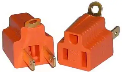

3-prong to 2-prong adapter
They come in handy when you need to plug something with three prongs, into something with two prongs. What I've never understood was, what the heck is the "grounding" tab for? It's meant to have the cover plate mounting screw through it. But why?

Yes, it's designed as a ground attachment. No, it's not simply to keep it from falling out, as evidenced by the style you haven't shown that provides a pigtail green wire, and the fact that the terminal in question is electrically connected to the ground pin of the receptacle side of the device.
Pigtail adapter
While it is true that this will not always result in a ground, and may (I haven't got time to sift through code, nor code on a computer to sift through) not result in a ground approved by code, it is, nevertheless, what it's there for, and in quite a few cases it does, in fact result in a ground - whether or not you like it.

So this is called a cheater for a reason -- it's actually used to plug 3-prong things in locations which are actually not grounded. Which, indeed, is playing with fire. For instance the one in your photo allows polarized devices to be plugged in (taller neutral slot), but its pins are not polarized, breaking polarization!
